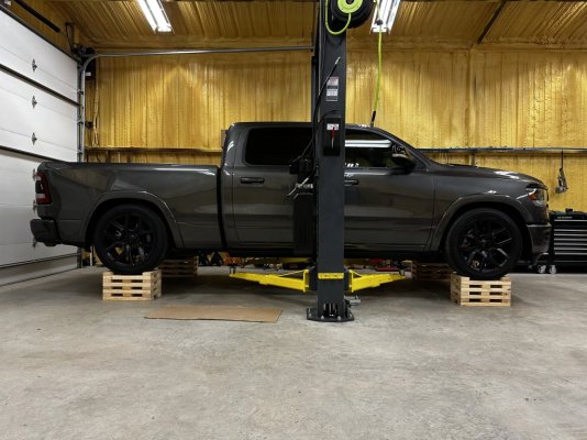

You might try having the truck on the suspension and then loosen and retorque all of the bolts. You might have some binding issues. I’d recommend building some wheel cribs from 2x4s. This works really well for lowered vehicles. Gives you room to get under it with a load on the suspension. I wish I could afford to have a two post and four post lift, but my two post will have to do. It’s times like this that a 4 post would come in real handy.
