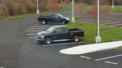

Dont you plow snow? wouldn't you want the front higher?

I do plow. That's why I want the back to come down to the height of the front. I'm not touching the front of the truck. My light weight plow has no problem with the front height. I just want to level out the back to match. Here is a new picture of my truck from my new office building. You can see the rake I have is pretty high.
