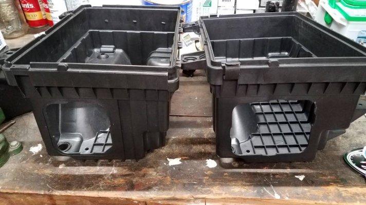

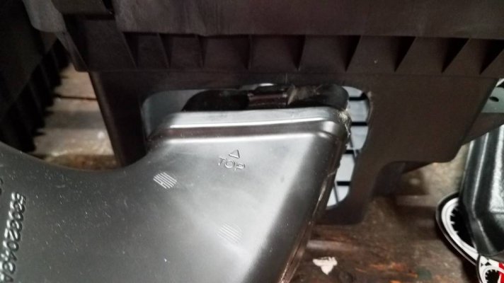

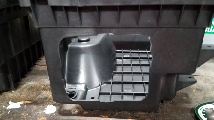

Thought I'd share this with the forum, the Ecodiesel lower airbox takes the same air filter and top lid as the 5.7 trucks but has an inlet that is roughly 50% larger. The part numbers for these are:
Inlet: 68190706AB
Lower Box: 68232657AC
Links to where I got them:
https://parts.allmoparparts.com/oem-parts/mopar-air-inlet-duct-68190706ab
https://parts.allmoparparts.com/oem-parts/mopar-air-cleaner-body-68232657ac
I took a pic of my Trinity with some air intake PIDs to show it flows really well.
These parts cost around $60. So for those that want to keep things all factory parts but want to have a better flowing intake without spending hundreds this is a good choice.
Please note this is not needed on the 6.4 trucks as they already have a lower intake box that uses the bigger Ecodiesel inlet tube.

Yeah the fender opening is the same. However the factory 5.7 inlet tube takes the fender opening and makes it smaller where it goes into the airbox. The Ecodiesel inlet tube stays the same size as the fender opening right into the airbox.
Ah sorry, I missed your inlet tube pics!
Thats a big improvement in airflow for pretty cheap as opposed to aftermarket! Even the 3" add a tube I added to my oem box made a difference
