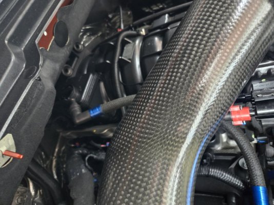

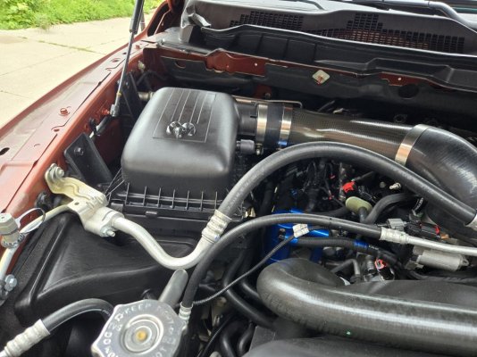

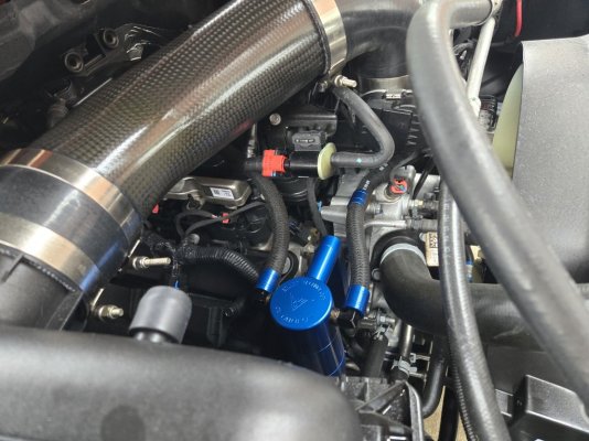

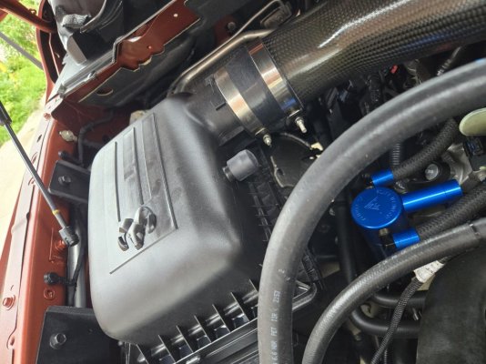

Not advertising for Legmaker at all, but they are some dang nice intakes that are custom made to order for only MOPAR applications. Functional artwork.
