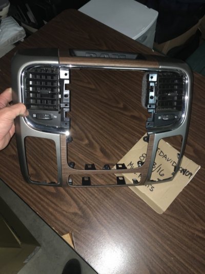

This is what a complete replacement bezel comes with

How does the center one come around the cup holders? I have the chrome one and the damn beams off from it.....annoying.

You just pry it off. There are 2 tabs on the front and back, and I believe 1 on each side. Get your fingernails under it and just pull up. It's easy.
