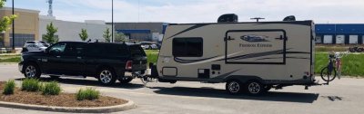

Congratulations. I pulled my hybrid only two months after I got my 18 5.7. Crew Laramie from Ontario to Florida and we never had any issues. The trailer brake does most of the work and your truck will be fine. My hybrid is 5500 fully loaded

Can I ask what is the brand of your hybrid and size. We love hybrid camping
