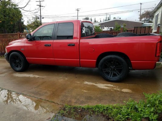

I've been running 305/50/20 with a 2/4 drop for several years now. No rubbing problems unless I'm cornering really hard or loaded up and hit some good undulations in the road. I've had the stock petal wheels and now aftermarket with almost the same offset/backspace.

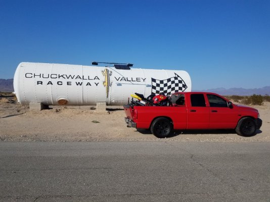

I honestly don't recall what width the wheels are. I think either 9.5" or 10". The tires are Toyo Proxes STII and are the 3rd set of those on my truck. I like them that much. Got the whole package at Discount Tires, they said the rims are very close to the stock petal leafs. I like the tires protruding from the rim a little as they protect the rims from curb rash.
Getting in and out for me is fine, I'm 5'9" around a 30/31" inseam. Just have to lift a cheek a little to plant it on the seat and get in.
The rear sits a little higher on mine with the 2/4 drop because I have an add-a-leaf installed. I use the truck for hauling motorcycles to the track, along with all my gear and **** so wanted to make sure it maintained a level ride when loaded up.
Here it is fully loaded for the weekend at the track.

That loaded pic is about what I'm going for with mine, but unloaded. And I think the stock petals are 20x9's. IMO, I think I want 20x10, anyway. Slightly better look and slightly harder sidewall for better cornering with a flush tire-to-rim rather than poked or stretched.

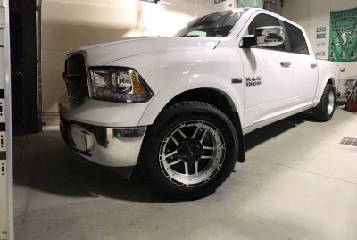

20x10" 305/50/12 tires (summer) 33x12.50x20 AT (winter) 2" rear drop.
Planning on 20x12 -44 with 305/50/20 and H&R front drop springs next spring.

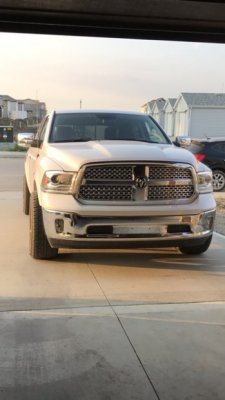

One upload per reply is a bummer!
