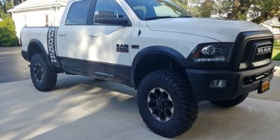

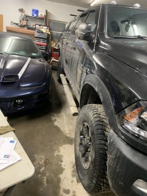

Chap
Nov 29, 2016
87
58
Northern NY
2019 Powerwagon
hemi 6.4
That white power wagon with the 37's looks bad ass. Makes me want to get 37's for my truck. I am running 35-12.5-17 Yokohama Geolander MT's, no rubbing at all. I have a 1.5 inch leveling kit, wonder if that with the 37's, there woud be no rubbing issues??
olyelr
Nov 18, 2018
5,597
4,616
Kewadin MI
You are basically at the same height as that white truck. Pretty sure he has thuren springs up front, which are 1.5” taller than factory springs. If you stick with stock wheels you would have very minimal rub on the fender probably, and some minor rubbing on the radius arm.
