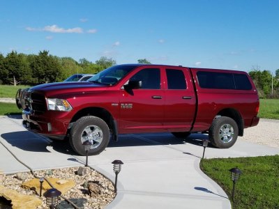

Yes bills all the way around, on my stock tires it sets at 39 1/4 in the front and 40 1/4 in the rear.
