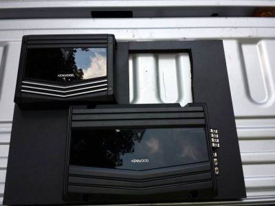

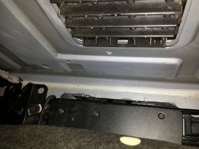

I am using the space behind the rear drivers seat to mount the Amps. I cut the factory sound deadening material just large enough to fit them. Took measurements for my bracket and did not have a piece of MDF large enough to work so I pieced it which is fine IMO. While the paint was drying I scuffed the paint behind the seat and cleaned it with denatured alcohol. I used liquid nails to secure it.

Just a guesstimate, about 4" over the vent and 1" everywhere else. There is a large hump over the vents for air flow. The main motive was to have a secure place to mount the amps out of the way.

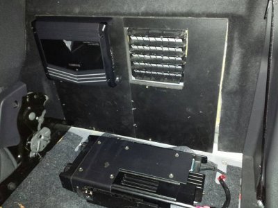

Started to mount the amps, but decided to wait until the glue completely dries. The equipment mounted on the floor is a VHF fire radio FYI.

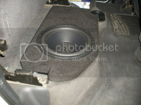

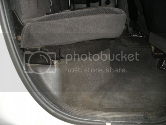

Ordered my sub enclosure a few days ago. Ended up going with Net Audio, I just don't like the look of the Fox Boxes. These enclosures are custom made to order, 4 layer fiberglass in the bottom and completely contoured and rounded edges. To top it off he has perfectly matched carpet. Multiple enclousures to choose from as well. Here is the model I ordered:
I know ya'll are gonna ask.... It was $200 plus $40 flat rate shipping.
NET Audio
BTW these Photos are from the website.
