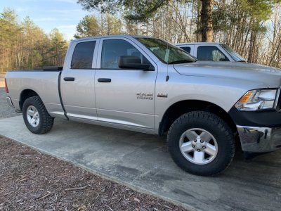

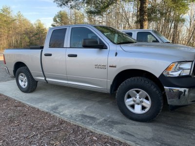

I have everything finished up now and rolling along.
Bilstein 5100 Shocks up front set @ 2.1
Bilstein 5100 Shocks in the rear
17x8 wheels from a earlier model (2003) to ensure proper width wheel for the new tires
AMP Terrain Pro LT285/70/17 tires
Ride quality is totally better now. I wish I had done this when the truck was new.

Looks really good. Been contemplating the exact same mods. Got any before pics for comparison?

Here is the before with the LT265/70/17 and factory suspension compared to the after.
