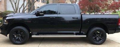

16495125-9FEE-45E3-993F-8892803000A8.jpeg I went 2.8” with 1.5” steel spacers in the rear. I retained a 3/4” rake and I love it!!

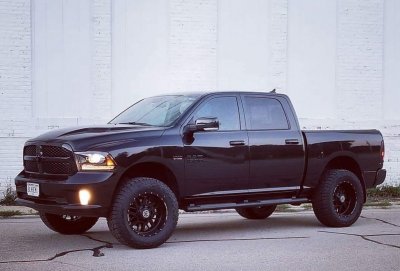

You have been my inspiration here. The first time I saw a pic of your truck, I said "That's how I want my truck to look" Mine was mushy soft at first and wondered how the lift was going to feel. Anyway I just lifted my a couple of weeks ago, to 2.8 and a 1.5" rear spacer..., but the shop skrewd up and set my 5100's at 2.1 but it drove like a dream only slightly stiffer. I went home and installed a Hellwig "That was a well needed mod" then took it back to the shop and they put it up to 2.8 now I've only got an inch of rake and it still drives like a dream. I couldn't be happier with the results. I continue to hear the echo on here that every truck is made different, though we both have SCSB's I love mine so far. I can feel the slightest bounce in the front end where the Bils' could use a little more compression and rebound dampening, but other than that... It feels great!
Oh...Yeah... I also installed a set of Ready Lift UCA's

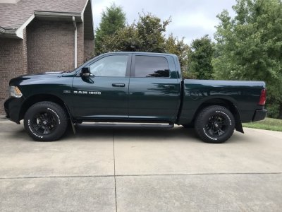

1332CEFC-B492-4E14-BE36-3A8512D71FC4.jpeg I went with 2.1 on the front, no mod to rear. Sits dead level. I wasnt going for height. Just level. I also wasnt going for 35’s, so 2.8+rear spacer not necessary. With this in mind, 2.1 front and then adding your rear spacer should keep an inch or so rake I would wager....but then every truck is a bit different.
I will say that if I pulled anything with regularity, I’d just install the airbags in the rear...easy fix to fight the sag...just my opinion...

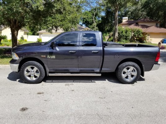

IMG_1042.jpg 2.1 Bils up front. Bils on back, also; otherwise stock suspention. Tires are 275/70/17 BFG AT TA KOs.
7/8 inch rake. Level if I put 250 pounds on back, just in front of the tailgate. I run my tires at about 36 psi. I really like the way it rides. Connected to the road, but not harsh. It's 7 years old, and still have never given a thought to getting something else.

How’s it ride with Bills at 2.8 and the additional 1.5” in the rear?
Nice looking truck.
Thanks! Rides great! I recall it made a considerable difference when I installed it. Now I can’t remember how it rode before lol. I also like the fact that it’s practically level when I tow my trailer with approximately 3000lbs.
