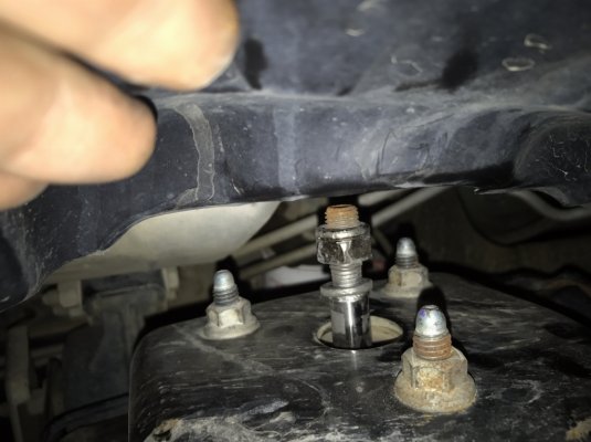

So I waited a week for my bils to come in. Got home tonight. Taking them out of the box. First one...perfect. On to the second. Top thread is all rusty, Allen head looks marred, and the washer is missing. I know i didnt lose it...noticed it was missing before openong the bag. Call customer service. They say I need the washer from that kit and I can't just buy another one. No good reason why. No explanation as to why the shock looks rough. And they won't send me a new washer. I need to contact the place I ordered them, file a claim to exchange it and wait a week or more for a new one to come. Was super pumped to install these tomorrow since it's the only day I have time to do it for awhile. Now I can't. All I hear is about how everyone has bilsteins and they're awesome. I'm pretty disappointed at this point. What would you do at this point?? Just go buy an exact same high strength washer and run It even though youre pretty sure it's been used?? Suck it up and wait a few weeks?? Anyone else have these issues??

Sorry to hear that. Where did you order it from? Personally I would get a replacement. If not, return them all or file a charge back with your credit card company and explain the situation. I would assume it would be in your favor.

Sounds like you got a second hand set. I would return it to whom ever you got it from

Post a picture of the allen head end
If the hardware bag was sealed it could be the factory just omitted the washer by mistake.

I'll have to take a pic of the head tomorrow but this is what the threads look like

Looks used! Wait or buy locally.
Came from local auto parts store. I guess I'll have to wait. Just makes a guy mad when you pay a lot of money for something new and they pull that crap. They could be at least cleaned it up a little to try pulling it off.

I just did mine for the second time I have around 150k on her. Anyway when I order mine from Amazon I had one without a nut and one without a washer and a nut. So I now have 2 nice 5100’s for the front that amazon just gave me. I was going to call bilstein and see if I could get them to ship to me.
