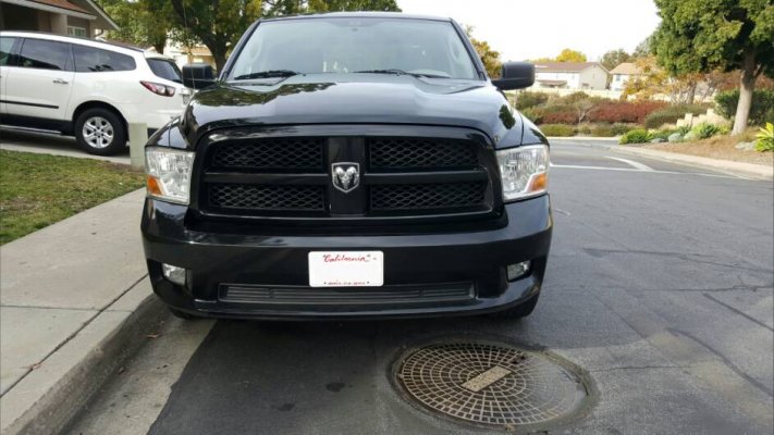

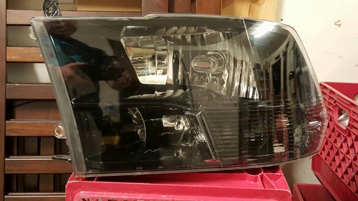

So I haven't post in a while but I have been working on some black out high gloss black. They were quite a pain to get the lense off with the oven trick and during the process I laid one of the buckets on a reflector and warped it so I think I am going to leave then out. What you guys think? Tonight I was going to put them altogether after one more coat of paint and got orange peel fml well sanding tomorrow
So step 1
Find a second set of lights because your going to get pissed off trying to get them apart. Mine 50 bucks stole them
Then put 1 light at a time in the oven on about 275 right side up or you will melt the top mount.
Don't listen to YouTube leave them for about 12 minutes and work them from the large clips
Dig in with a flat head pry out don't worry about the plastic you can heat it and mold it back
Put the bucket back in to loosen the glue it helps on removal.
The rest choose your color prep paint
I used RTV Sealant adhesive Black filled the channels pressed into place left a racket strap on till sealant was no longer tacky, make sure you cover the lense with cloth.
Your going to need 2 tubes of the sealant one for each and amber turn signal bulbs 3157 found that out afterwards oops
Be patient and good luck
