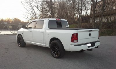

these are replica 22" srt's. 305/45/22 tire. 32.8" tall.
they rub at full lock on swaybar. also rubbed on upper control arm, took a grinder to it for clearance, otherwise need to run spacers.

looks great... any drop on there?

I just love that look, can't wait. Is it stock height?
