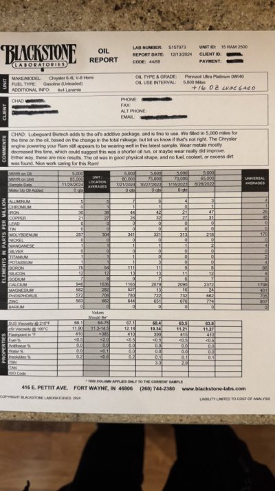

Latest report. PUP 0W40 with 16OZ of Lubegard Biotech. RP 20-500 filter. 5K OCI. About 4K miles of this was towing my boat or 21' enclosed trailer both of which are around 3500 lbs. Neither have a high frontal load compared to the truck camper. Prior to this result was contemplating going to a high mileage oil or Redline or HPL as my PUP stash is gone. Think I'm just going to stay the course. What say you???

Looks good, but the additive numbers are a little puzzling. I'd get another uoa in 5k miles with the same oil 0e40 pup just to figure why. You had exactly 7 qrt pup 0w40 and biotech and nothing else?
Same recipe inclusive of the 70K analysis. The one at 65K was just PUP. All other with 16 OZ of LubeGard & RP 20-500 filter. Was using Wix XP prior.
