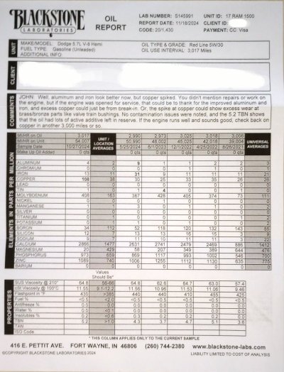

Ok, I drove around adding the mileage needed(3000 miles oci)so I could send Blackstone Labs my oil sample ... otherwise, it'd be around the second week of November due to my normal driving/mileage habits.
Also, I'm curious, is to the accident that my truck suffered this time last year, that might have caused any internal engine damage. My HEMI's last report showed much higher than normal wear of iron and aluminum that might be from that accident ...
I'll be changing the oil this weekend and report back the results.
Fingers crossed that it gets an good clean bill of health ...

... added note.
My HEMI has had normal wear numbers since new to current from Blackstone Labs.
However, from the last report after the accident, six months later, the wear numbers of iron/aluminum were on the extreme side.
(I perform 3000 miles oci's since new and this oci is @currently 54,000 miles).

Finally got the latest Blackstone Labs oil report on my 2017 HEMI.
It's about time, lol.
Puzzling, what a huge drop in iron and alum. So large something seams off, no way should you see that improvement in 3k miles unless the other uoa was severe duty and this wasn't. Guess we will really have to wait to see what's up next uoa. Seams like last uoa was the outlier, so maybe severe duty? Maybe you have an issue with some copper part during the severe duty? How hard did you work your truck last uoa?

Do you have any idea what happened last time? Any conditions different? Cold weather?
list all oils for those 6 uoa's? most of them 5w30?

Oils for those six oil samples are Red Line 5w/30.

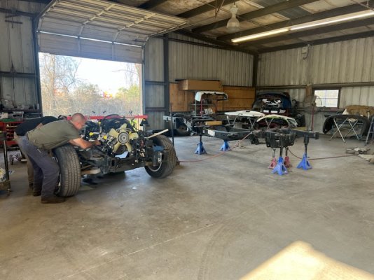

I do indeed know what's probably happended to my HEMI engine ... it probably didn't take the head on collision with an eighteen wheeler, this time last,very well ...everything on my truck was pulled off from the bent frame and was put on a new frame.
So, idk ...
Edited for adding a few pics.

The kinetic energy your truck, and subsequently your HEMI experienced during the collision, has possibly translated to cascade damages after the fact regarding your HEMI engine (and possibly your transmission, too!)!
This is something that most insurance companies work very hard to bury (transmissions, too!) to ensure that they aren't on the hook for, after the fact, for the damages that they are fully aware of that occur in these types of scenarios long term! (in my opinion!).
However, these types of cascading damages are a real thing that we must all be aware of, and fight upfront for to be indicated on the claims from the beginning.
For, in todays world of teflon suit wearing dummies that are out to break us and our rights to compensation for those future (edit-- AND.. cascading) damages that are inevitably inherent and we are rightfully entitled to!

Man, I am surprised they didn't total ya, it must have been close to 80% of the value, they usually total it. I think the elevated copper suggests engine damage, it would be a legitimate case. Who decided to fix it and not total it? you, your ins, his ins?
