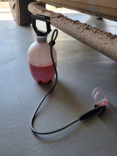

Get yourself a garden sprayer. Remove the tip of the nozzle. It will make life so much easier. I got this one for $20.
The plastic home depot sprayers work as well, plus are a bit smaller so you dont have to reach as far to pump. You can also remove the wand and add a section of tubing so that you have a bit more room to work.

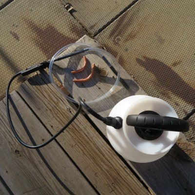

Mines a 1 gallon version,modded with extra hose and a couple differant copper tubing ends to fit differant applications
