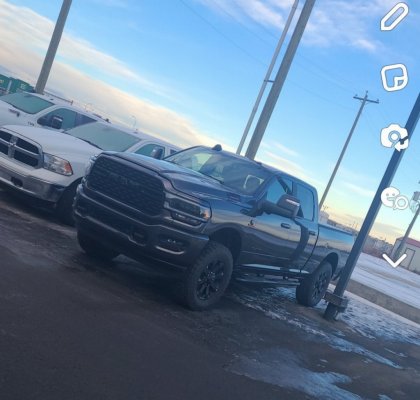

Hey guys. Glad to be apart of the forums thanks for having such a helpful place in the worst of times. I stated in the title the best I could of the package of the truck I bought 2 months ago so you'd have an idea of how many options there are. NIGHTMARE BEGINS! Few days after buying the truck the screen shut off, blind spot alert is going off every 5 seconds, the side windows don't work, locks don't work(only from fob), ac doesn't work and on the driver door, just ahead of the window and mirror control panel is the new tow mirror buttons in which the lighting buttons don't work but the extend and bottom mirror buttons do. I bought my truck, the one I wanted and found out of BC, where I had the dealership also install a leveling kit for now, new tires, running boards and spray box liner. and had it shipped to Grande Prairie where right away I installed a tonneau and rat pack . I'm explaining all this cause maybe during any of those after market installs could of triggered this , possibly shorting
or failed light or something or it's in any of the sensors or options that's not working. First dealership couldn't figure it out. Second dealership said bcm so truck sat for 7 weeks till new one arrived and still not it. I've heard taillights have been cracked and moistures set in but I don't see that either. I'm all ears if there's been some updates on past resembling problems.
