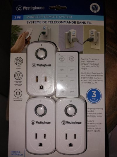

What about a home automation switch that turns the block heater about 2-3 hours before I have to leave if the outdoor temperature is below 40F. :cool: Being in Michigan the temperature can go from freezing at night to waking up to 60°F and then dump a foot of snow later that day... LOL
I picked a bargain on a 3-pack of AC outlet switches with wireless remote control.
I've been meaning to see if they will connect from my house to the barn in my avatar and use one for the block heater.
Then once I decide on a departure time, just use the remote a couple of hours before departure. A warm truck is a great feeling in the cold winters of Canadastan. :cool:
