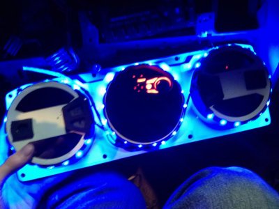

Just wanted to share this with you guys. I just finished it all up and put it back together last night. What everyones thoughts on it?

Pretty easy actualy i dint take to many pics as i was doin i thought about that after i a put it back together haha. But i just put led strips around the back of the gauge cluster and put the wires into one of theprevious dash bulbs. And the best part is that they dim with the stock switch

WOW that is great. Can you tell me where you got the LED strips from and did you do to put them on.

Just ordered 4 pack of blue led strips off amazon like 12$$ and the have sticky tape attached to theem so they just stick on

I'm doing something similar right now. But using the stock lamp holders w blue white led bulbs. I didn't do the stick on kind only because here in new mexico it's so dry, those would stick till about the first month of summer and fall off.

I know this is a old thread but can you tell me where you ordered them and are they led? I tried some green LEDs and for some reason the dash fuse would keep blowing so I just replaced them all with regular bulbs thank you very much
