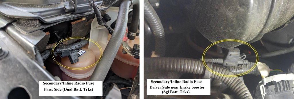

You could try pulling the radio fuse for an hour. It's all on its own, below the master cylinder.
Which radio is in your truck?
@SitKneelBend is our resident radio expert.

Everything but the radio display functions, correct?
Possible that fuse is just blown if the screen is black.
