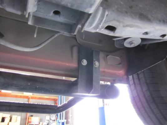

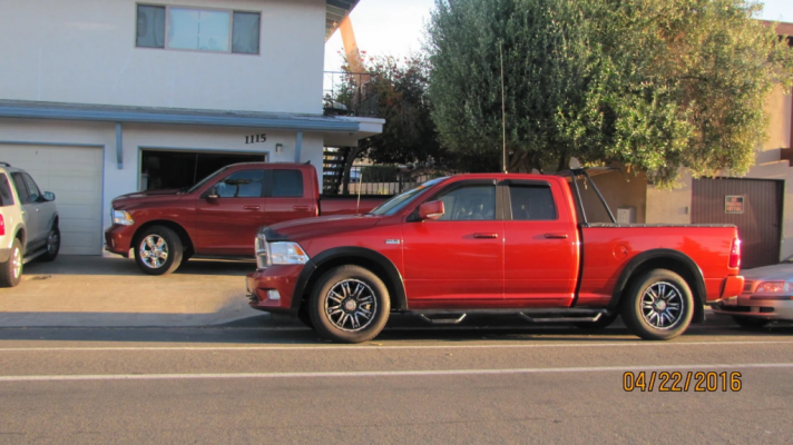

neither my 2009 or the 2016 Rams nerf bars bolt to the frame
My nerf bars are modified, imagine 3 steps, all like the front step
2 were cut off & one long step replaced it
The long one suits my needs better
front mount
Center mount
rear pix seems to be missing
I know some people have rust along the mounting area
But, a person could buy 2 long 1/4" thick steel bars, that are about 2" wide
Those long flat steel bars, could be mounted to the trucks mounting area & the nerf bars could be mounted to the bar.
If, the rust is not too bad, that should gave you plenty of support
Other wise, a person could pay a welder to make brackets, that bolt to the trucks FRAME
Good Luck
