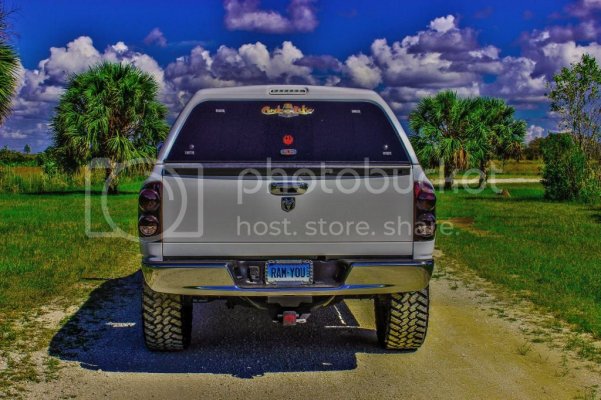

Here is mine 2" level,3" body lift with 35's. You can see the hitch under the bumper, I made a piece out of sheet metal to cover the gap, bolted to the hitch and 3m tape to the bottom of bumper.

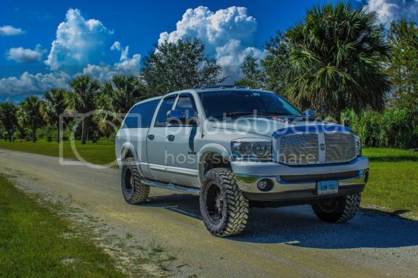

I don't think there is anything other then a 3". If it helps here is a pic of my truck when I had a 2" level/3" body lift and 33/12.50/20 tires. I think you would be ok with 34's.IMG_1685_zpsfam2sbeo.jpg
