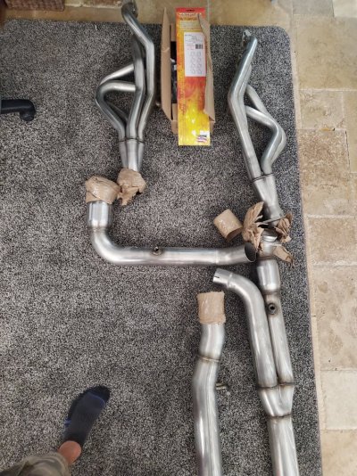

I will let you know after July 6th when the procharger kit is installed and tuned with ARH longtube headers.
Nice but something to consider; When you supercharge a vehicle this negates the whole reason for long tube headers which is the scavenging effect. The only other advantage is they are more free flowing than the stock manifolds. I would reconsider long tubes and just go with a set of shorties headers. They are not much difficult to install than the stock manifolds and generally much cheaper than long tube headers.
I know you always see long tubes on any performance engine with a blower of some kind but this is more "bolt-on fever" than considering the real performance benefits.
ksonnen1
Apr 6, 2018
41
39
florida
There is nothing for me to consider. I have two friends with 6.4 supercharges who both have had increased HP and torque thruout the range with the longtube vs the stock manifold on 2500 truck and the other challanger stock shorty manifolds. During the initial tuning they both had less boost with the longtubes but with tunning they both acheived easily the same hp/tq then the stock manifolds with less boost. When changing pulley's to the get back to the initial boost they had and then tuned again there wasn't even a question that the longtubes with same amount of boost netted more hp/tq. Both were tuned and dynoed by the same shop and i have seen the results.
I will add there was much more hp/tq gains on the 2500 truck 6.4 going from the oem exhaust manifolds to the longtubes then there was going from the challenger shorty type oem exhaust type headers to the longtubes.
