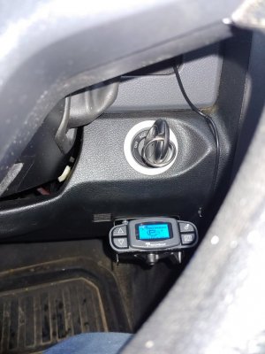

If that was a question, then yes you do not need to have your truck flashed when using an aftermarket brake controller. I use the P3 as well. I mounted mine on the right side of the steering column. I'll post a pic later when I get a chance.
Here's where I mounted mine. I wanted it well within reach of the manual switch.

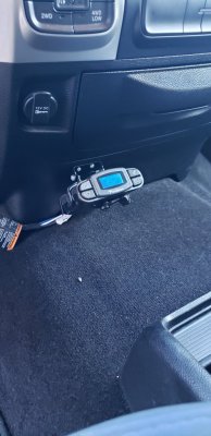

Any chance you would mind sharing a pic of where you mounted your controller. Also if aftermarket there is no reason to have your truck flashed as you would with a OEM controller.
Thanks again!
Here's where I mounted mine. I put it just below the storage drawer. The drawer opens fine. I was going to mount it to the right of the steering column, but I couldn't see it while I was driving. Hope this helps.20190425_074044.jpg

Perfect!!! Much appreciated... So the wiring hook up is right behind where you have the controller mounted.
