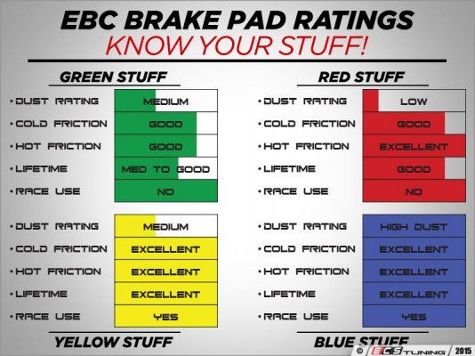

For you EBC guys, help.
Looked over their web site trying to understand the differences between all the colors they offer. For the most part, the descriptions all indicate the same thing, that is, race car, drifting, SUV, and towing applications.
So, what color do I want?
I'm towing 15,000 pounds of RV and want a little more stopping power from the truck (3500 Cummins). Second, the factory pads must think there are a crop duster the way they can blacken my wheels after a few hundred miles.
Do you do just the front brakes, or the rears also?
So, if you are going to throw a color at me without an explanation, please don't and, "there the best" doesn't count. I am really interested in understanding the differences between the color offerings and their web site is of little use.
Thanks guys.

I use Yellow Stuff. I like them as I never notice any brake fade. The draw back of them is they have to have some heat in them to bite good. If you are a tailgater these are not for you. EBC says they are track pads but I use them daily and love em.

The greenstuff 7000 is a low dust ceramic pad that’s great for day to day driving, with minimal towing.
The yellowstuff is a aramid and ceramic fiber brake pad that has more of a bite to it compared to the standard OEM pads, and can tow larger trailers.
The Extra duty are going to be the best if you ride the brakes hard, and is the best for towing heavier things.

I have had the EBC greenstuff HD for the past 25k miles and they are awesome pertaining to performance. Downside, bad brake dust. I wont be using them again only bc of that issue, going to be looking at a ceramic

I love my Yellowstuff on my Avalanche (sorry ;) ) they do leav more dust than normal pads and more that Greenstuff that I used before.
They bite soo good :happy107:
