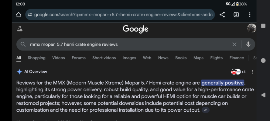

A quick AI search of reviews, for comparison:
Awhile back I emailed some of these rebuilders to see which brand lifters they used in their "remanufactured" engines. If I remember right, Jasper said they have their own house brand (I'm skeptical). Several said they were OEM, but were "tested". I specifically asked if "tested" means used, and he wouldn't say no. Just stated again that they were "tested", but wouldn't say how. (I took that to mean they were reusing used lifters).
