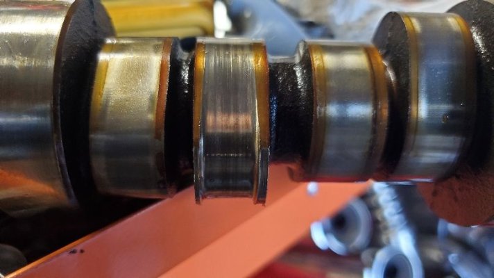

One of the two damaged lobes on the original engine's cam:
