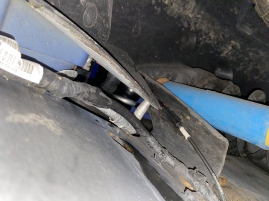

Hi, 2018 2500. Looks like I have a break/ tear in my passenger front break line. Is it worth upgrading to a set of stainless steel lines?

I'll also agree the OP's photo is not a brake hose or line.

That is not a Brake line, it is part of the wiring harness. The ABS sensor is the single cable to the right.
The fluid you see is most likely coolant from the reservoir right above that or condensation from the AC. Mine looks the same, not an issue.

Thanks for all the input everyone. It was tough for me to tell as this was of course after dark last night. I’m no mechanic which is why I came here to post. Thanks again!
