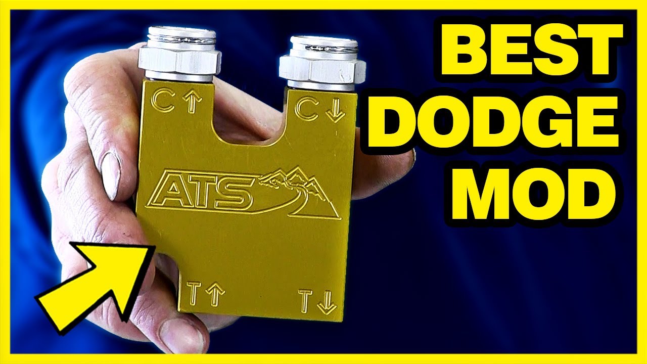

Yes. Most RFE transmissions fail from too much heat. Ancillary equipment needs to be replaced with the transmission. Yes, this is a "thing" if the thermostat bypass isn't removed. Don't put another one back in or it will fail again at the same mileage. Put in a "bypass" block from RevMax. Then use oxidation-resistant trans oil. Red Line +C ATF is a favorite around here for buttery-smooth shifting.
And yes, that is what I have in my 66RFE transmission.

I doubt the dealership will install an aftermarket bypass. If they will I'm sure they'll void whatever warranty the new transmission comes with.
I would change out the lines and cooler. If it was a warranty thing and on their dime I doubt they'd change them out. They'd flush everything and hope they got any and all the contaminants out. Then pray it makes it past whatever the warranty period is.
Depending on how long you plan on keeping the truck I'd look for an actual transmission shop.
I highly recommend the bypass and redline c+ like was mentioned.

The factory lines probably have a spot for the thermo valve, they might want to put it back for legal reasons as well, so you might have to dyi after, see video below, locate it on your truck, easy swap. Redline c+ is a great upgrade but they will need it all when they fluid up, like 14 quarts maybe more for a hd might want 20 on hand or 5 gallons extra is fine no shelf life. You really need this simple upgrade too, but again they will need it now. Is the trans being put in now?
So the thermo valve is a terrible fail point, the bypass looks identical but has no valves, just flow.

The 66rfe takes 12 quarts, only 157 now shipped to your door. Ask if you can use a thermo bypass instead of the factory thermo valve, or just ask if they can supply that instead on thermal valve, if not it's ok you can do that anytime like even a year later, do that at your convenience. good luck with it
