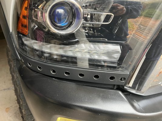

The stock one does pull in "some" air in 3d Sim. I do agree it needs to be higher to best optimization. Which is what we did. 3/4 of inch higher than stock.
Didn't want it look ugly, but also functional. Since it was all done on 3D sim, and I never put them on, hard to say the exact high in practice would be.

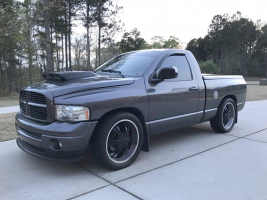

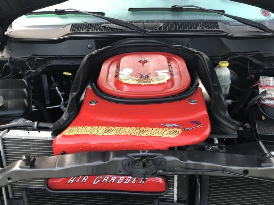

I have a Vararam on mine as well. But the front scoop of mine is just black while my file=ter cover is orange, like my truck. Did you do the red one yourself? I don't have the airgrabber scoop either. I feel a little jealous over that. LOL

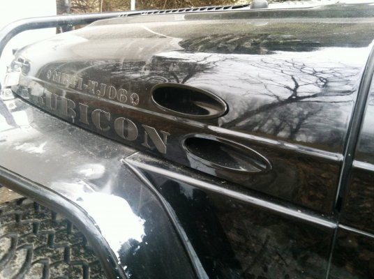

I think the original question (IMHO) was to cool the engine bay. I been wondering how to evacuate the heat from under the hood myself. On my Jeep I used one of the top of the hood louvered plates, but I found that the 56 Buick port holes I installed on the side would flow much more air/heat from under the hood then the top louvers.
I did, I actually made it to go with my Vararam, which doesn't exist for my year model truck in this configuration.
It's actually Chevy orange, Hemi orange wasn't orange enough.
