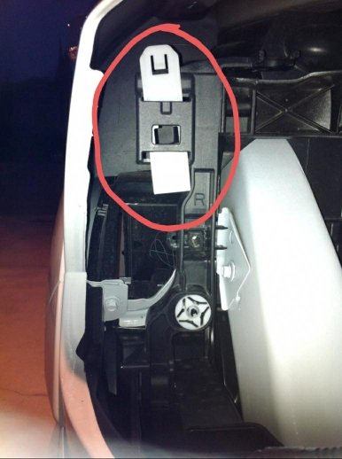

How do I remove my headlamp if the retainer clip is missing? I've removed the bolts and it's still snug. I'm scared to push it out in fear of breaking something else.bbf750392989e742582c452b41c85f46.jpg

That doesn't look broken.
You push up on the white clip to free the headlight, that clip is in the released position now.

That's just the clip for reference. Mine is definitely broken/not there.

If it isn't there, it isn't holding your light in place. The ball socket is probably dry and holding tight. Mine were a bear to get out the first time, smeared a little vaseline on them and they come out much more easily now.
I use a wide plastic trim tool between the fender and headlight to pop them loose.

if you need clip its mopar part#68050777aa

Did you get the bolts out in the front? You may need to loosen that side of the grill also.
