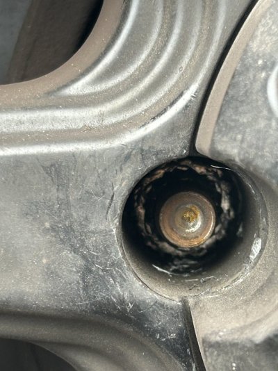

I have a broken lug on my 8 lug 2500 wheel. my question is can a half of a lug be burned off with an acetylene torch succussfully without damaging the stud? There is not a lot of the lug left. I tried to use a few extractor lugs and all they did was shave the lug. So I could possibly shave it thinner. i thought mabyr the torch could melt it without melting the stud. PICS might be hard because its in the hole. Only about an inch + of the lug in there.
Update:so I tried to hammer the lug removal socket up over the lug with a sledge and it mushroomed alot of it against the rim. So again womdering if a torch might melt the rest.IMG_3944.jpeg

I'd be worried about the torch heat destroying the wheel. Aluminum melts at a significantly lower temp that steel.
I just realized that part of the lug nut is still in there, making removal of the wheel difficult. In this case, I would use a drill diameter slightly larger than the stud diameter and drill the stud out. After it is gone, remove the wheel and replace the broken stud.

Drill the stud out it its not hard at all to replace a wheel stud.
