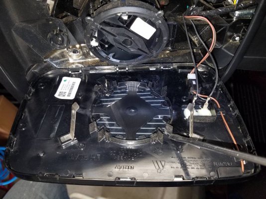

Yes you can replace just the glass of you can verify the style/attachment method. I've seen them on eBay.
You may want to contact forum vendor AllMoparParts.com (Benny) and see is there is an official Mopar glass PN available.

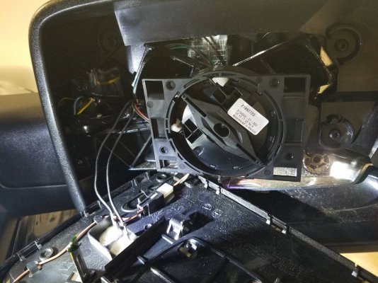

Not sure if your 17 ram sport is the same as my 18 Laramie's power fold mirrors but the driver side attached different than the passenger side.
Driver side followed the power fold glass removal directions.
Pass side followed the standard glass removal directionsView attachment 18 Ram 1500 Mirror Glass Removal - TA.pdf
Driver (see round mount on back of glass)
Pass. Side (see rectangular mount on back of glass)
