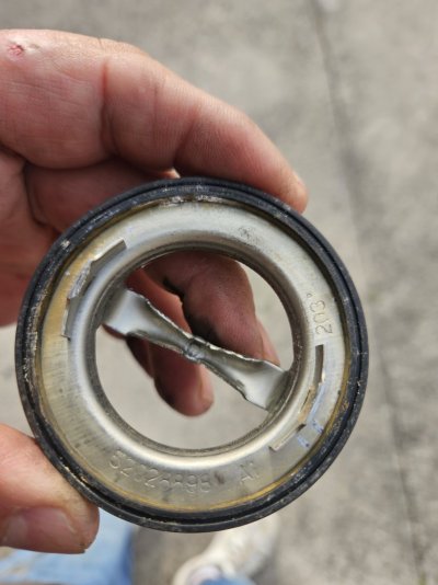

Thank you to everyone here for the help and guidance! This is the first time I've replaced a radiator. As always, hit a few hiccups along the way but more or less, it went pretty smoothly.
Hiccup #1 - Petcock popped out and I got a nice coolant shower on my face.
Hiccup #2 - Took forever to get the lower hose off! My goodness. The step that I least expected to give me trouble.
Also, I always thought hose clamp pliers were a useless tool. Today, I stand corrected. I would have paid $100 for this tool.
As for the reservoir, there was a good amount of rust/sediment in that thing, hence the super dirty/dark dipstick. I gave it a good rinse. Also, there was similar residue on the underside of the radiator cap. (See photo.) Not a good sign.
The coolant that was drained had a cloudyish red/brown color. The container in the photo is white opaque so it doesn't show it well. That was one gallon. The rest landed on my face. :) I ended up putting about 2 gallons of new coolant after the install, which means this wasn't a full flush. I'm assuming some of the old coolant is in the engine and elsewhere.

I bought the truck used about 4 years ago and have not put in any coolant myself. I bought the purple stuff 50/50 mixed for topping off in the short term and I ordered a bottle of the concentrate for when I do the install/flush. As for what coolant was/is in there before, I can't be sure. The color of the coolant that was leaking was a reddish/brownish color. Unclear if that's the dye of the coolant or from rust...
I've seen where "stop leak" added to the coolant in the radiator looked like that ... maybe someone/previous owner had a "leak" and added that to "fix" it.? ...

@shon914, did you run extra water through the system?
Thats alot of crud in there. How much was in the reservoir?
The next time I do mine I will do several drain and fills with distilled water, then top off with straight concentrate. Still deciding on the method, because just draining the rad only gets maybe less than half out.
I did not. I thought that since I'm replacing the rad, I don't need to flush with water. If I'm understanding you correctly though, you're saying to fill with water after the install, let it run/cycle, flush again, then add coolant? In hindsight, this makes sense to get more of the old coolant out.
Yes.
I cut an old thermostat apart and reinstalled it minus the guts, then ran distilled water into the upper hose, letting it run out the bottom hose that was disconnected from the rad.
Not sure if that would remove some of the crud from inside your system.
I am against using any flushng chemicals, too scared of causing other issues.
But filling the existing system with water and running it through a heat cycle, and repeating several times might get more of the crap out of the system so you dont contaminate the new radiator.
The gutless thermostat should allow for better circulation while you do this, just make sure you bleed the air out each time you refill with water, and after you install the new rad.
Looking back through the thread, it looks like you are pretty much done with the repair, and what you've done has to be a giant improvement over what you started with.
Looks like you did a good job on it.

Given the looks of that radiator cap
Using distilled water might be akin to trying to hold a t u r d by the clean end.
But, I guess it can't hurt either.
I think a coolant flush with some rmi25 or CLR would be a smart weekend project in the near future. (Then, use distilled water).
