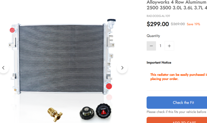

I put one of those in a few months ago. Couple of problems I ran into.
1. Had to trim the upper shroud about an inch or so. It was too tight and hitting up against the belt and pulleys.
2. The side where the A/C lines mount do not line up. I still need to rig something up to bolt the holder on. Thinking of using a spacer and longer bolt, haven't gotten around to it yet.
3. It comes with a 19 lb cap. Stock is 16. Been using the 19 and haven't had any issues yet, but, may switch back to the stock cap.
4. The lower "skid plate" does not line up with the mounting holes on the lower shroud. Need to make new holes to get it back on. haven't done that yet, either. I will eventually.
Other than that, it is working well. takes a little longer to warm up, but, not too much more.
Going with a lower pressure radiator cap just lowers the boiling point of the coolant. It might give you the option to pull over and shut the engine down before it blows the coolant out.
There's been some members on an EcoD forum that have upgraded their radiator to radiator you installed, they said it makes a considerable difference in cooling as the lower part of the radiator is heat soaked by the intercooler.
The 3.6, 6.4, EcoDiesel, Cummins and other various motors by Dodge all use a 21 psi rated radiator cap.
