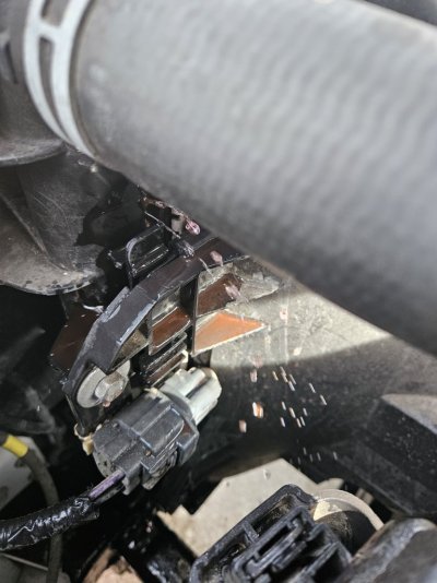

Was changing my headlight bulbs and noticed a leak from the driver side radiator area under the hood. Brownish liquid with not much odor. No issues (yet) with overheating. Then with the engine running, I spotted some small bubbles coming from the side of the radiator. I recorded a video of it but can't figure out how to post it here so here's a photo for now.
Has anyone dealt with something like this before? What's the best course of action to address this? Thanks.

New rad,a few guys on here have had good success with the aftermarket aluminium radiators

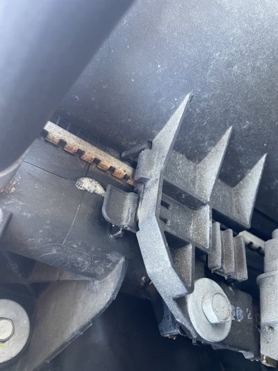

This pic is with a pressure tester on the radiator, set to 15psi, it's leaking in exactly the same spot as yours. You might be low on coolant.
Mine overheated 8 hours before a road trip, that could've been bad if it waited a couple hours to happen.
If it overheats on you, and you don't catch it quick, could warp the heads or worse.
Good luck.
