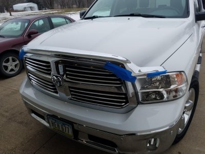

I've been fighting a whistle while driving. After much painters tape, it would appear that is coming from the Stampede Vigilante chrome bug sheild. I've had it on the truck since I bought the truck new in October of last year, but I haven't driven it much. If anyone has the same bug shield, do you have a whistle? I was convinced it was coming from the drivers side A pillar at the wind sheild, but after I taped everything and it didn't stop it, I taped as you see in the photo.....no more whistle.

Yes. Windows up. Once I taped the empty spaces between body and shield, whistle went away. Ended up taking it off. The dealer even commented on the loud whistle.

I can put it back on in about 5 minutes if I take my time. I will eventually put it back on probably, but that whistle is so annoying.

I think the door leaks air slightly. Going to have it adjusted. I think the whistle will probably hopefully be gone then..........or I'll leave it off.
