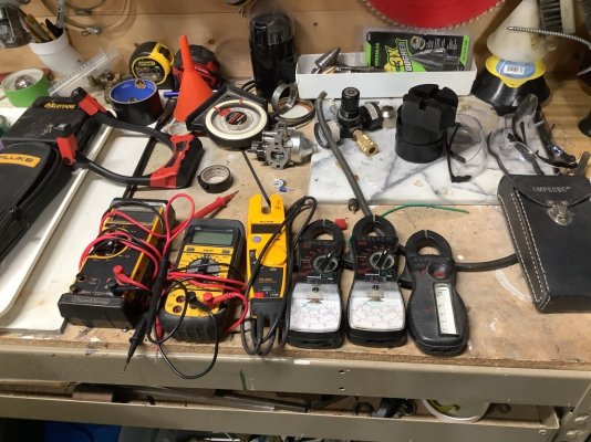

As much as I can appreciate installing an ammeter on the battery cable, I am far too lazy and have too many other areas to spend my time. :cool:
I've played this game before with mystery currents, it's not too difficult, just tedious and time-consuming. I would prove the battery status before embarking on the electrical gremlin adventure.

You don't want an amp meter on the battery,you want a volt meter.With an amp meter it has to be wired in line,between the positive battery post and the postive battery cable,and has to be able to be big enough handle the amp load when starting the truck,and if it dies,you're buggered,while a volt meter just needs to hook up to the positive and negative posts and doesn't have any load running through it.
Actually, I couldn't be bothered to install an ammeter in line with the battery, way too much effort. :cool:
And, that is why I bought a DC current-measurement-capable clamp meter. I'll post pics soon'ish.

Years ago alot of vehicles did use an actual amp meter,and if the amp meter in the dash died,the vehicle wouldn't start.
I can understand that.
I know it's impossible to remember everyone's background but I started learning electronics at about 8 years old and was fixing appliances, power supplies, TVs and radios in my early teens. :cool:
