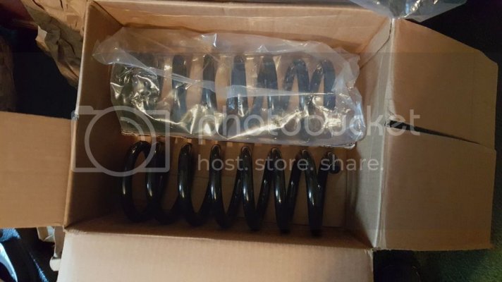

A couple weeks later, the real fun was about to begin. I had been doing a lot of research, shopping and looking at pictures to decide what I wanted to do with the suspension. My 17 year old son was pretty adamant about me raising the truck, since he has a bunch of friends in the 4WD community, but with a 3.7L that can't get out of it's own way to begin with, putting larger wheels and tires on it just wasn't in the cards. I've always been a lowered guy anyway, so I pretty much had my mind set on lowering, the question is simply "how low" and "what to use". Since I have been out of the game for a while, I used this forum to do some research to see what everyone was using and settled on the fact that I wanted to do a 5/7 drop on 22's and that the McGaughy's kit was the way to go, so the order was placed.
About 10 days later, 133lbs of boxes arrived at the house.
i had plans to let it sit there and do an entire suspension rebuild at one time, but boredom got to me this past weekend, and I decided that since I do not have to drive the truck, I would go ahead and start working on the drop and then just add the rest of the parts as they came in to spread out the work load.

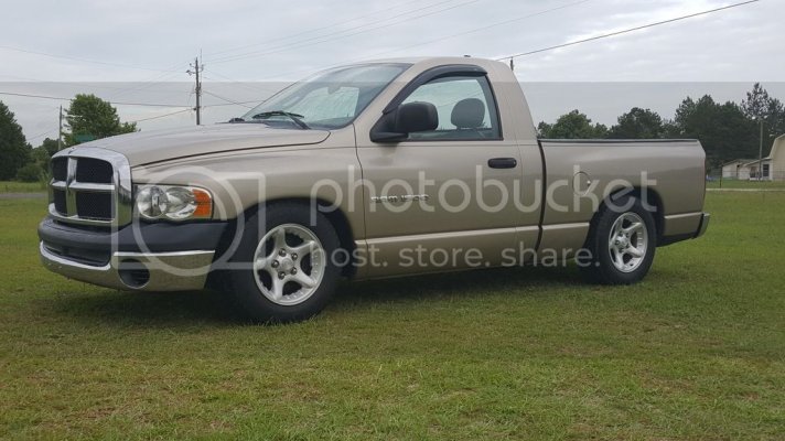

I got the flip kit done on Friday and the front spindles and springs installed on Saturday. The install was pretty straight forward, although you do learn a lot of shortcuts doing the first side, which makes the 2nd side go a lot faster. I also learned that pretty much everything in the front end of the truck was worn out. My only suggestion to someone who wants to do this themself is to ensure that you have all the tools required before you get started. There are a few that do not come in your standard tool set. 21mm and 24mm will be your friend. I also suggest a large breaker bar, most of the suspension bolts are a bear to get loose, even on a rust free truck that has been in the Southeast it's entire life. I feel for you guys trying to do this on trucks that have lived up north, that has to be a nightmare.
Here is how she sits currently:
Currently waiting on: Upper Control Arms, Lower ball joints, Lower control arm bushings, ultra low profile bump stops for the front and wheel hubs.
Still waitiing to be installed: The C-Notch kit..... This will happen sometime this week. I also need to weld up the spring perches.
Still need to order: inner and outer tie rods, steering rack bushings, leaf spring bushings, McGaughy air bag kit for the rear and swaybars.

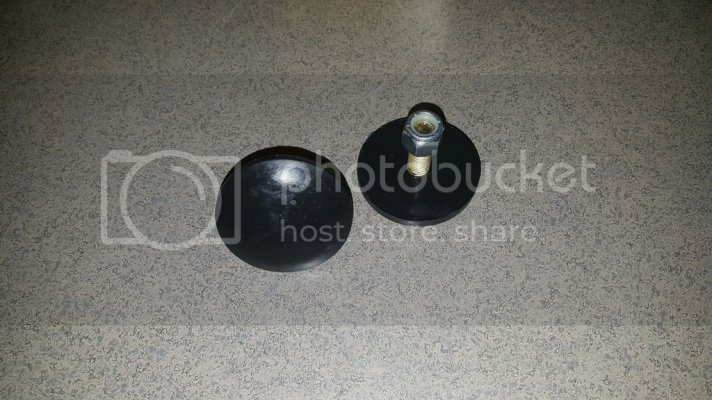

Worked on the truck a little bit while I'm waiting on some more parts. I had pulled the bedliner last weekend and there was a mess underneath. I should have taken pictures before, because there was so much crud underneath, even the pressure wand at the car wash couldn't make a dent in it.
So I broke out the scrub brush, dish soap and water hose and went to work and this is the final product. This should cut the work required for prepping for the Monstaliner quite a bit.
