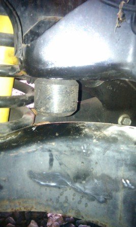

What does the kit consist of? I found with the OEM cups removed, the added travel caused some bump steer along with allowing the tire to hit the inner fender wheel. I have Timbren rubber springs installed as bumps which limit the travel and bump steer. Just wondering what is being offered.
