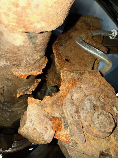

The front trailing arm (on passenger side) let go off the axle, see pics. Curious if anyone has had to deal with this - I'm told there are brackets available to repair? I have a good welder available, but just hoping to find an existing, tried & tested, solution. Thank you!!!

I found this site/page but doesn't look like the bracket is a 'part' i can buy:

Judging by your pics, I would plan on needing to replace more than just the bracket. The caster bolt and control arm are likely rust welded together. Start tearing it apart and see what is even salvageable and go from there. The bracket should be easy to make.
