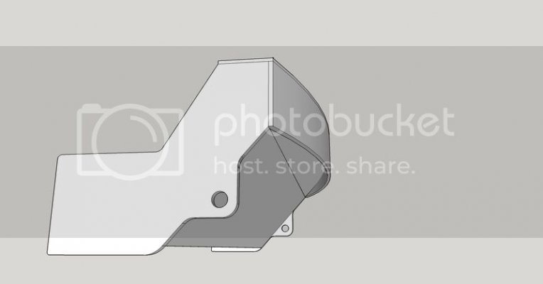

I am designing a bumper for a 2004 2500, and have a good idea what I want. Or at least I thought I did. Here is what I have so far...

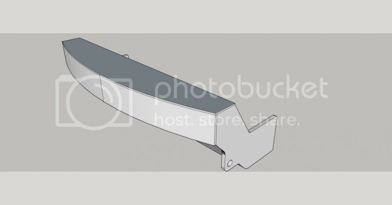

I designed the top plate to match the curve of the grill, and to sit nearly in the same location. I only pushed it out 1/2 inch to help clear the 12k winch thats going behind this thing. I like the curve, I am not crazy about the gap between the lower plate and the curved plate. I have the tools and know how to make the curved face plate, but no way of making those two plates meet to make it look decent.
I would love some feedback or ideas on how to make this thing look decent. My plan at the moment is to continue the factory curve around under the headlights too. I could honestly be talked out of the curve under the grill, I just wanted a tucked away, clean look to the bumper.
Thanks for the input guys!
EDIT: To be clear, I can make the plate curved in CAD, I cannot make the actual plate in real life, I don't think.

Elongate the lower plate, match the cut to the curve of the other plate.
I did that, but it still left the gap between the curved plate and the lower plate. It would probably never be that noticeable, but what if it is!? Ha

Once you get the sides and top plate cut, then they can be used to mark the sheet for the lower plate cut. All you have to do is measure twice, cut once.
Right, but here is my concern...
That gap is still there. Granted, unless I put the truck on C-130 tires I will probably never see it, but I will know about it, and it will bug the crap out of me.
I could do it like this...
And close the gap, just having trouble visualizing it in real life, and whether it will look goofy or not.
