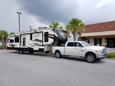

I have a 6.4 with 4.10s and went from a 34' TT to a 42' 5th wheel. Same truck. I find the stability of the 5th wheel to outweigh the added weight over the TT. The only issue I have is chucking from my pin box, so I'd recommend having them throw in a cushioned pin box on the 5th wheel, even just a More-ryde or a Lippert Rota-flex. Otherwise, I recommend the 5th wheel for towing and for room.
Are you sitting level and where's most of your weight on the 5er in relation to the 5er axle? Can probably fine tune alot of that out? What pin box and what hitch?

I didnt notice a lot of drap really with mine. I'm sure there is some, but I don't really notice it much.
As for sitting level, it squats my truck about 1.5" to 2" before I p ut any air in the bags. I just have the standard pin box with the B&W Companion.
This pic is the day I picked it up. I did t have any air bags at the time and hadn't adjusted the hitch any. I did have the junk from my TT loaded though, so it wasn't completely unloaded.
