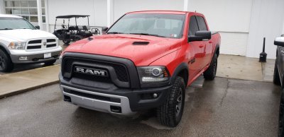

UPDATE: Sorry for the delayed update but I picked the truck up last week and drove from Ohio to TX without a single issue. The truck is surprisingly quite, even more quite than my wife's Denali. I wanted to update you guys with a photo, this was my first time seeing it in person -
