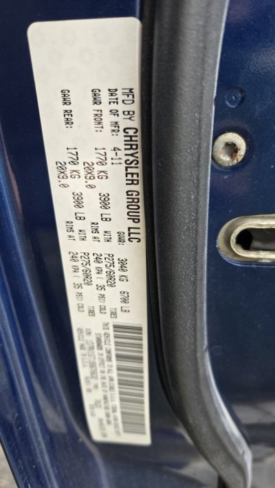

Just checked AlfaOBD and it doesn't even show a BW44-44 option for an '11 under "Vehicle Config 3: Tcase Type".

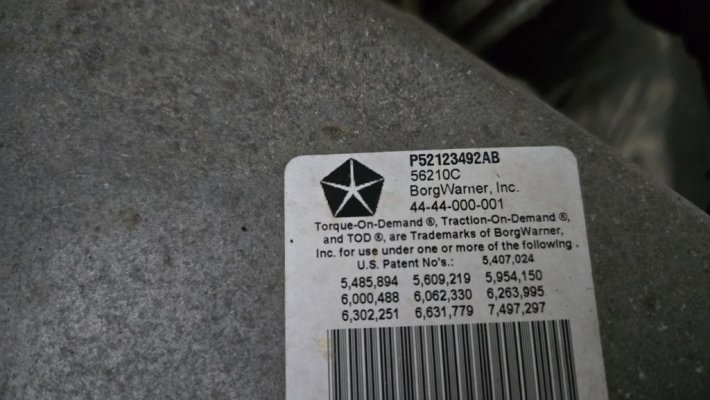

I thought it was weird too, but i checked the tag on the case and it does have a BW44-44 sticker from factory. ill send some pictures shortly. I was on car-parts yesterday looking at cases and it didnt even give me the option for the 44-44 for 11. only gave NV243 or NV246. I had to go up to 12' to get the 44 option.
If i have to go the rebuild route, are nv243 the same parts in an early 44-44?
Edit: would a 2012 BW44-44 be plug and play for the 2011 if i can find one cheap?
or would i have to program the BCM for a 2012?
