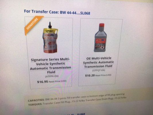

This doesn't mention the years, and I trust Amsoil more than anybody when it comes to fluids....
