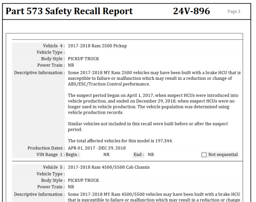

Actually have my 2018 Ram 2500 C4B (NHTSA 24V-896) recall completed!!!
I don't normally post on the forums, but love the information I can find here. Thank you all for the immeasurable help you have provided to so many people like me.
Many folks are frustrated waiting for Stellantis to contact you about the new HCU being available, I was in the same situation. The week before last, I decided just to see if ANY WEBSITES showed the parts available online. I found a some Mopar stores that actually did and sent online requests to a couple of dealers parts departments that said the parts were available. I got positive responses from a few and they stated that I could come in and get the part or have it shipped. One of the Parts Departments was the Dealership I have used for previous recalls and some service. A very nice employee sent me an email indicating that the correct part for my VIN and the NHTSA Recall (24V-896)/Manufacturer Recall (C4B) was indeed in stock and available. I called her and asked if she could hold it for me while I contacted the service department to set up the recall service. She did so and sent me the internal Service Order number to show that the part was being held.
I was able to schedule the service last Monday, and provided the Service Order number for the held part. The advisor said that would be their first performed recall for this issue. It was a couple days to get it completed, as apparently the Technician had to get the recall procedure from Chrysler.
I have had no issues (lights/error codes) in the past week.
The NHTSA Recall document is the only one that I found that had the part numbers listed on it and that is what I searched for in the dealership inventories.
Involved Components :
Component Name 1 : HCU
Component Description : Brake HCU
Component Part Number : 68143491AA / 68195569AA
Bottom line, at least for me, I had to find and reserve the part myself to have it available to schedule the recall repair.
I don't know if it will help others, but
Best Wishes and Good Luck!
Part # 68143491AB
  • RCLRPT-24V896-3848.PDF

Every dealership I call says they only have the fix for the 3500 cab chassis. I called Chrysler Care, and they told me the same. The HCU was already replaced once in 2021 and now is failing again. Just curious if when you called the dealership did they say anything to you about only being a part for cab chassis? Super curious how you got yours fixed, when I keep getting the run around. I’ve got a 17’ 3500. I put my vin in mopar online store and it clearly states the part numbers you listed fit my vin number, yet the dealership just keeps saying it’s only for 3500 cab chassis, which makes zero sense. Chrysler tried to tell me they still don’t have a release date for the parts. Yet they are listed on mopars website. Super frustrated as all my abs lights and traction control lights are coming on.
They didn't read down far enough. The 2500 is Vehicle cat 4 and is indeed included in the recall. Tell em to read it again, in full.
