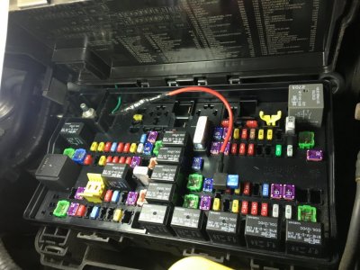

FYI, the fuse box tap posted earlier in the thread are a GREAT idea. I had originally T'd off my right front parking light, from behind the light which was a tight spot, and I didn't do the best wiring job in there and was not happy with it. So I ordered that fuse box tap, and just removed my T from the headlight and moved the power wire to the fuse box via the tap. Works nice, looks better/cleaner wiring, and now the OEM headlight cluster is not "tampered with" if ever I have a warranty issue up there...
:33:
Glad they worked out for you

I can't tell from the pictures, but does this fuse tap work with the "M case" style fuse, or just the two blade style ?
Thanks

This particular one works for the Micro2 ATR fuse ONLY. BUT, there are similar fuse taps for many different size and type fuses out there. Search amazon....

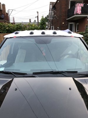

I did the same and wired into F79. Here are some pics in the install. I was so nervous about drilling 15 holes into my truck but I’m very happy with the end result.

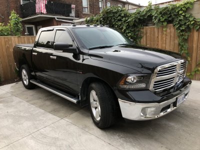

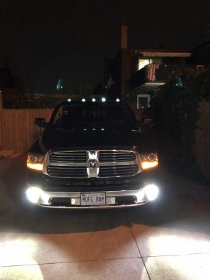

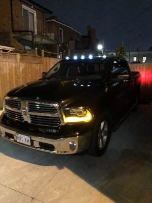

Some more pics. I also tinted the lights to match my truck colour.

Seanbeck, interesting that the light even shows thru the black paint???
Have you checked your local laws? In NY your not aloud to have white marker lights, they have to be orange...
I haven’t actually checked the local laws. I’m thinking of changing the bulbs from white to amber anyway. I think it might look better.
I used a spray black tint which allows light to pass through.
